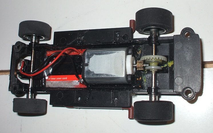

Wobble Posted October 31, 2017 Report Share Posted October 31, 2017 (edited) I've got two of these and neither gets much of a run these days so I decided to try and upgrade one a bit without resorting to a 3D printed chassis. The standard tyres are too big so Scaley Mustang rears sanded down are on the front and NSR tyres on the rear and the body lowered on the chassis about 1.5-2mm. Initially I thought about trying to convert it to sidewinder but then I decided to attempt to use as much of the stock chassis and running gear as I could so the motor mount was cut out and superglued and epoxied into the rear and the front filled with a bit of old bank card. The motor is an Ebay 18k find and the adapter is one from ZeGas. At 82gm all up and with tracks as wide as a Scaley Camaro I'm hoping it might be a reasonably competitive runner in our 18k Trans Am and American Muscle class. There's also a Cobra Daytona Coupe in the drawer that might get the same treatment if this runs as good as it looks. Edited April 20, 2018 by Wobble Quote Link to comment Share on other sites More sharing options...

Wobble Posted October 31, 2017 Author Report Share Posted October 31, 2017 (edited) The looks of the car has always worked for me too and when I had the chance of the 2nd car recently I got it with the intention of modifying it. I also picked up a Cobra Daytona and another Revell silver wide body racing E-Type to do like Mac did a few years ago so I'm hoping this was worth the effort. We have pre 80's sport racing tonight so this should fit in quite nicely. The left body with interior below the dash cut away and front and rear clips glued to the body is 26gm.. The body on the right is slightly modified to lower it on the chassis a bit is 30gm. Edited April 20, 2018 by Wobble Quote Link to comment Share on other sites More sharing options...

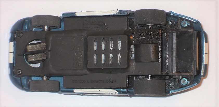

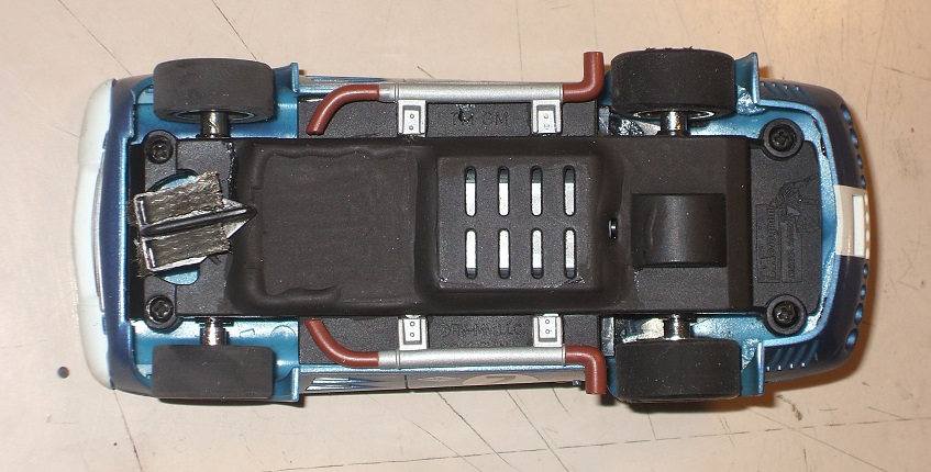

Terry Posted November 10, 2017 Report Share Posted November 10, 2017 Great looking Cobra Bram, Can you show a pic of the chassis please? Terry Quote Link to comment Share on other sites More sharing options...
Wobble Posted November 11, 2017 Author Report Share Posted November 11, 2017 (edited) Great looking Cobra Bram, Can you show a pic of the chassis please? Terry Here's a few. Fortunately the bod I got it off had already started on it and the rear body float works OK with the rear clip screwed on tight as the chassis is modded to float inside it. Hoping it's clearer than mud but if you have any other questions, fire away. In this photo you can just make out the bottom of the body post below the chassis. Edited April 20, 2018 by Wobble Quote Link to comment Share on other sites More sharing options...
