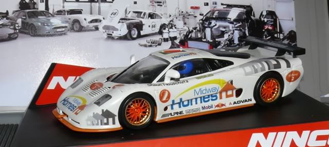

Ember Posted October 18, 2010 Report Share Posted October 18, 2010 I have a white Ninco Ranger, like the one below, that I picked up cheaply on fleabay and have a mind to give it a personality change. I've had success with a metho bath for removing paint and tampo on SCX and Scaley shells, so figured the same method would be fine on Ninco. Gave it a tentative soak to test before plunging the shell straight in for the long haul. Two hours in soaking and a scrub with a toothbrush results in nothing. Not even the surface of the printing has been broken. Gave it another couple of hours with still no visible results. So. Does anyone have a no fail, no fuss, quick results formula for use in stripping a Ninco shell? Cheers Embs Quote Computers. They'll never catch on. Tiny Tyers Targa - The build saga continues - Aging wood - A recipe for staining wood - Don't take a fence - Step by step paling fence - An old shed for my new cars - Wooden garage under construction Link to comment Share on other sites More sharing options...
