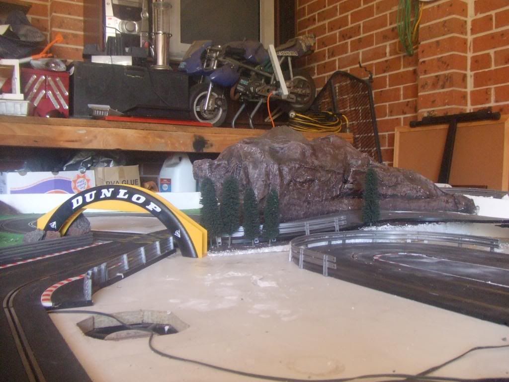

auphartz Posted November 15, 2010 Author Report Share Posted November 15, 2010 Thanks very much everyone for all of your tips ...I've managed to get close to what i wanted I just have a spot of greenery to add Quote Link to comment Share on other sites More sharing options...
Ember Posted November 15, 2010 Report Share Posted November 15, 2010 Yup. Looks good to me. I'd just suggest a quick spray with some Dullcote or something similar to get rid of that slight gloss that has built up. But really, colour and texture is looking good. Embs Quote Computers. They'll never catch on. Tiny Tyers Targa - The build saga continues - Aging wood - A recipe for staining wood - Don't take a fence - Step by step paling fence - An old shed for my new cars - Wooden garage under construction Link to comment Share on other sites More sharing options...
silver rocket Posted November 15, 2010 Report Share Posted November 15, 2010 Looks pretty good, do you plan to add ground cover? This will help dull it... but yeah it's looking good Quote I Miss Brocky... Link to comment Share on other sites More sharing options...
GTR XU-1 Posted November 15, 2010 Report Share Posted November 15, 2010 Auphartz, It could be just the flash on the camera...but I would either use ground cover or even just a light spray with matt clear on those rocks.....just to give it that bit extra.....but lookin good Will look a bit like a bathurst cutting when its finished. Dave Quote Link to comment Share on other sites More sharing options...
auphartz Posted November 16, 2010 Author Report Share Posted November 16, 2010 I'll get some dullcoat on the weekend , thanks for your help . I am planning to add a few small shrubs and a sprinkling of ground cover Quote Link to comment Share on other sites More sharing options...
