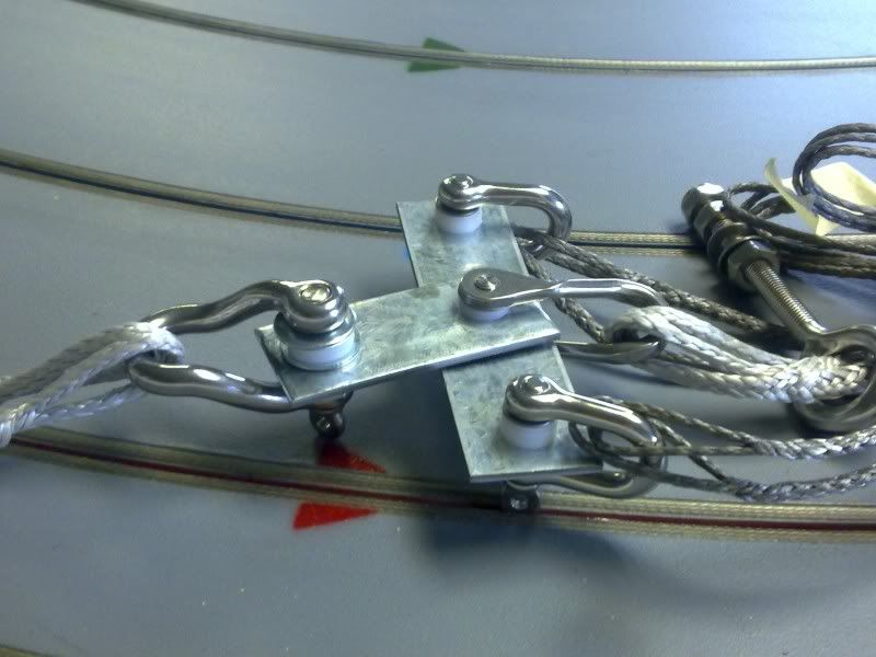

BMR Posted July 2, 2012 Report Share Posted July 2, 2012 (edited) This is what I meant by steel galvanised balance plates , the cables from the sides of the track go up to the top pulley blocks then change direction through another double bolted pulley then on to this arrangement below - this set up allows the cables to balance the weight side to side . On the track I used large eye bolts so there was some threaded adjustment to set the cable tension . 3mm dynex lead ropes carry the weight from the sides then 5mm dynex rope at the left of the photo carries the main load . The centre shankle ( u bolt ) has another 5 mm dynex rope that trails back to the other end of the track and conected to the other lifting balance plates . It looks complicated but really all it does is balance out the load better instead of messing around to adjust the eyebolts at the track and it self adjusts for any initial stretch in the rope The stainless steel u bolts / shackles had wire through the threaded pins so they cant undo 8mm Shackles were about $7.00 each from memory rated at 2000kg 6mm shackles were about $5.00 each rated at 1500kg click to enlarge the photo Where the cables all meet just before the winch I used this arrangement so the cables could align easier with the winch and the point they were pulling from The eyebolt with the blue rope on it is a safety thing - it was lowered after this photo to allow the 5mm rope to run through it , so if ever a pulley wore out and let go there was the eyebolt there to catch it all . I also doubled up and used two 5mm ropes ( just in case one got an unseen cut in it ) to do the main load lifting my oval track ended up around 350 - 400 kg The set up I used in the end could probably lift a small Korean car or two but a bit of over kill is better than lying flat on the deck with a track on ya belly huh Edited July 2, 2012 by BMR Quote Link to comment Share on other sites More sharing options...
