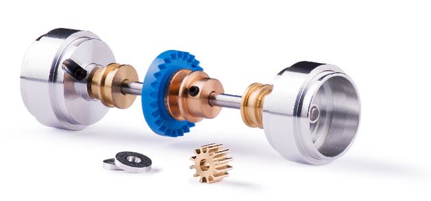

Slotspeed Posted June 20, 2018 Report Share Posted June 20, 2018 Not sure how the Slot.it tyre measurement system works. I had a look at the Slot.it tyre selector but that was pretty useless and minimal measurements were listed. I am looking at these wheels: http://www.armchairracer.com.au/workshop/wheels/slot-it-wheels-pa20-als-f1-1-0gr-aluminum-14-5-x-12mm-std-hub I am assuming the 14.4mm refers to the bead diameter, but I am not entirely sure. I am assuming the 11.5mm refers to tyre width, and not including the spigot width. (I guess that's what the 12mm is that Armchair are referring to) So scaling the photo I get approx 6mm internal tyre step width. I would normally just contact the shop but they are moving today and tomorrow so probably not a good time! Cheers for any clarification. Steve. Quote Link to comment Share on other sites More sharing options...
SlotsNZ Posted June 20, 2018 Report Share Posted June 20, 2018 Not sure what chart you were using, this is the current one. 14.4mm is the diameter of the centre diameter. So the correct tyres are those of the DWG 1068 size - any of their F1 tyres If you want to use another brand tyre you'll just need to check dimensions, but in general, the step height and width on Slot.it and most other brands for modern F1 are so similar they are mostly interchangeable. But if you want F1 wheels and tyres for an older F1 car, the Policar F1 wheel and tyres are slightly larger - 16 x 11.7 and have C1 and F22 formula tyres to match. Quote Custodian of many used screws (quite a few loose ) * Recovering Lapsed Slot Addict * Companion of other delusional slot addicts * Total kidder Link to comment Share on other sites More sharing options...
Slotspeed Posted June 20, 2018 Author Report Share Posted June 20, 2018 Hey thanks for that. Assuming by center diamater that you mean the external rim size rather than the internal size for the removable plastic centre? Yes that was the chart I had looked at. Its a little frustrating as other manufacturers seem to give more info away regarding the sizes of the step, step depth, overall diameter including step, etc etc. I have some NSR F1 tyres which I am hoping to use, but failing that, I will have the perfect rims to suit the Slot.It tyres. The wheels are for one of my Carrera 917k's. I machined one set down to suit NSR F1 tyres (Overall diameter of the step was too deep before machining) but wanted to try Slot.it wheels on the second car. Going to see if a Slot.It crown, axle and bearings will fit while I'm at it. Will solve a few problems in one go hopefully. Quote Link to comment Share on other sites More sharing options...
SlotsNZ Posted June 20, 2018 Report Share Posted June 20, 2018 Now I hear your situation - you are probably better buying a complete Slot.it "kit" for that car. It works out cheaper than individual bits. I have no idea what a "removable plastic centre" is. These are primarily alloy wheels. Slot.it have tried to simplify the matter into a "these fit those" system rather than have everyone trying to figure out all the dimensions. - You obviously have a maths and numbers brain, but a lot of the people I deal with can't get their heads around a whole lot of data sets (4) for widths of centre, overall wheel width, width of boss, step height. Then you need to understand that a given tyre will fit a couple of wheel sizes or more, and they often need to know the O.D. with THAT tyre fitted, or another tyre fitted, to check it suits what they want... Their brains just fuse and they want a simple answer. The chart provides all the information in a grid system - just look across and look down, choose the size wheel you want, the tyre compound you want, and the O.D. you want. No other maker does that. You don't really need to worry about width of the centre, and how deep the step down is, because the main alloy wheels and aftermarket tyre makers are very similar. I can take any NSR tyre and fit it to the same nominal O.D. and width Slot.it wheel, and vice versa. All you really need is the O.D. the width of the rim - typically a nominal 8 or 10mm, and the width of the boss if distance between the outside of axle bush and inside of wheel arch is restrictive. Slot.it parts are probably the simplest way forward - their range is pretty broad and readily available; and there are several other makers using the same axle diameter, same gears modulus and same gear diameters, so you still have the ability to mix and match brands to a fair extent when you are scratching around your war chest to sort out bits for a car. I suggest you measure 1) the O.D. of the centre - which is probably between 16.5 - 17.3mm 2) The width of the wheel excluding the boss probably 10 - 12mm 3) the width of the wheel including the boss 4) The width of the wheel with tyre fitted - to check you will end up with a usable O.D. with the new alloy wheels. You can then choose probably a 9.75/10mm GT type wheel (not the one you were looking at which was an F1 wheel), just as wheels, or as part of a kit; and choose a tyre to suit it. If the car is an inline the KK03 for older cars, or KK17 kit might be a good choice I am not familiar enough with their sidewinder setups to know if one using the same bush as Scalextric and 18mm or 19mm spurs will suit.. Quote Custodian of many used screws (quite a few loose ) * Recovering Lapsed Slot Addict * Companion of other delusional slot addicts * Total kidder Link to comment Share on other sites More sharing options...

Slotspeed Posted June 26, 2018 Author Report Share Posted June 26, 2018 (edited) Ok, so the Slot.it wheels arrived from Armchair Racer. I ordered the day that they were moving. So was expecting the order to take a while. But it only took a few days by regular auspost to get here! Quite impressive that they were able to move the order during a busy time like that. To my surprise, the diameter that is used by Slot.it (14.4mm in this case) to describe this rim is actually the outer diameter of the wheel including the step. That leaves the tyre inner diameter (bead as I like to call it, I'm sure there is a better name) at 12mm. Which is a bit on the small side for my application. (Original wheel is 13mm on both front and back) so it is going to look a bit odd from a scale model point of view, but I'm hoping it will be ok from a performance point of view. Apart from that, the tyres I was planning to use fit just fine. The OD of the mounted tyre is 1mm smaller than original for the car. So my overall gearing will be slightly lower, but I'm more worried about the ride height dropping that 0.5mm. The rear of the chassis already sits slightly lower than the front as standard, thanks to the Carrera track rails sitting slightly higher than the track surface, though new set up will be a slightly lower CG. Shut up and put the wheels on I hear someone say! Will be fun to see how this goes! Here is my sketch of the wheel dimensions... (Edit... the small black thing is the plastic insert that comes with this wheel) Edited June 26, 2018 by Slotspeed Quote Link to comment Share on other sites More sharing options...
SlotsNZ Posted June 26, 2018 Report Share Posted June 26, 2018 Yep, that's why I was questioning you buying F1 hubs and tyres instead of the GT wheels and tyres, but you indicated you wanted a scale look with high profile tyres. I normally call the outside part the "shoulders" Quote Custodian of many used screws (quite a few loose ) * Recovering Lapsed Slot Addict * Companion of other delusional slot addicts * Total kidder Link to comment Share on other sites More sharing options...

Slotspeed Posted June 27, 2018 Author Report Share Posted June 27, 2018 (edited) Assembled and test drove. Didn't use the Slot.it crown gear after all. It had an extra 3grams on the original crown gear. I managed to remove the original and ream and glue it to the new slot.it axle and it was still intact and as true running as it was on the original axle. Re-used the original Carrera bushings, they were pretty much the same ID as the slot.it bushings. Trued the tyres. On the (plastic) track: Lower drive ratio very noticeble, even though I only lost 1mm overall diameter from original wheel/tyre combo, makes a big difference. Car stays slotted when wheels set for wider track but a horrible driving experience. Though it looks and feels much faster (compared directly against my other Carrera car with original wheels but with same NSR tyres as this one) Narrowed the track by 2mm as a test. Car more controllable in the corners but it bounces around horribly when getting too hot in the corners. Not a nice experience, Tried a softer NSR compound, even worse! I noticed my wife to be's Sideways Hurracan has a wheel/tyre combo that has perfect outer dimensions for this application, those tyres are very soft and pliable, even while on the rims. (The hurracan handles any plastic track anomolies or inconsistencies like they are not even there! Though obviously the suspension on the hurracan is nothing like a Carrera car) Next experiment will be to swap them onto the 917k and see how it goes. Getting close to your first suggestion Mark, priority is the car needs to be driveable! Looks are second! Other option is to machine the original wheels like I did for the first car. But I don't have access to a lathe anymore. Edited June 27, 2018 by Slotspeed Quote Link to comment Share on other sites More sharing options...
SlotsNZ Posted June 27, 2018 Report Share Posted June 27, 2018 This will be an interesting learning curve for you, you'll gain a lot from this process. But to help narrow the suspects - Part of your problem is simply that you have a heavy Carrera body, and higher COG, but the bouncing is still most likely caused by the wheels/tyres being out of round, and/or slop in the rear axle bushes. Unless it has absolutely no wriggle at all, the bush/axle combination needs the big 86 and the matching buses/axles fitted. The lower gearing is unlikely to have very much bearing on handling, and if you have that low torque ff050 motor, that is probably a help unless you have a track with really long straights. One thing you may want to try, is using hot glue (which is easily removable), to ensure the motor is locked in place and cannot twist, and perhaps brace the back axle bush holders to the chassis and motor - as a temporary solution for testing, it can be as simple as more hot glue and some matches or tooth picks. Those together will reduce twisting of the chassis due to torque from the motor. - And you really will need to true those tyres by some method - preferably after gluing to the rims with a glue that doesn't react with the tyre compound. Some super-glues will cause NSR (and other brands of soft rubber) tyres to degrade and split Quote Custodian of many used screws (quite a few loose ) * Recovering Lapsed Slot Addict * Companion of other delusional slot addicts * Total kidder Link to comment Share on other sites More sharing options...

Slotspeed Posted July 26, 2018 Author Report Share Posted July 26, 2018 (edited) A week on and driving my other Carrera 917k was just so much more enjoyable in comparison, even though it was quite a bit slower. So I did some poor man's lathe work and machined the original wheels down to now take NSR F1 tyres. End result is ok. I'm a little annoyed that I have to retain the original axle. Which is pretty crappy and loose in the bushings. Reason I have to do that is because the original wheels are splined to go onto the Carrera splined axle. I am running a slot.it crown wheel (because I had modified the original one to go on a slot.it axle) which is also not ideal as it dosen't run all that true on the original axle. It is also quite heavy at 3 grams. The car however, is much smoother and more predictable, and slightly easier to drive. The best set up I had on this car was with the Sideways 17.3mm wheels and maybe I might try this again some day, but the scale appearance is important to me so I am happy with this setup for now. (edit: I will post some photos of the poor man's lathework at some point, and the final setup) Edited July 26, 2018 by Slotspeed Quote Link to comment Share on other sites More sharing options...
SlotsNZ Posted July 30, 2018 Report Share Posted July 30, 2018 Slotspeed, I probably missed some things while I was away at the Nats - but if you are able to do basic lathe-work - could you machine down the Carrera rear wheels to make inserts which fit a common 16.5 or 17.3mm Slot.it alloy wheel? That way you could use the Slot.it crown with 2.38mm axles that fit a standard bush - Slot.it also make bushes specifically for Carrera chassis. - You would then use an NSR tyre which is "high profile" to get the scale tyre look. [ NSR tyres fit fine on Slot.it wheels ] I am sure there is some way to keep scale appearance AND make it run really well. Quote Custodian of many used screws (quite a few loose ) * Recovering Lapsed Slot Addict * Companion of other delusional slot addicts * Total kidder Link to comment Share on other sites More sharing options...
