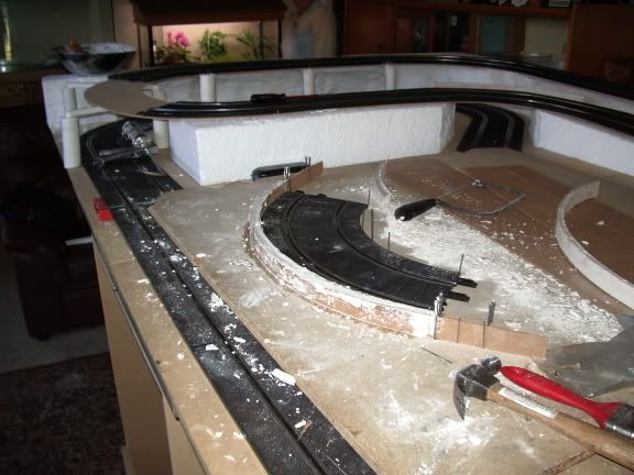

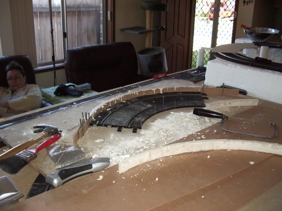

No pics available as the friends camera is on the fritz (dropped at the Easter show by her). Well all the elevations are in place and some of the rock walls are taking shape. Been cheating to get a good result for the rock faces by using a cordless drill with a wire wheel in it. You end up with a rough textured finish that just needs painting when using polystyrene blocks for landscape. Gets messy though so use a vacuum cleaner right next to the work to minimize the mess ;) . I only had to do a light vac of the lounge room afterwards. All the elevated road base is now in place using 3 mm mdf to get a nice transition. Using Bostik No More Nails has been a bonus. It will stick the plastic track to the board well but if you need to take it up, it parts with the board and then it comes off the back of the track fairly easily when pried off with a screw driver with no damage. Started to add plaster where I can without it getting damaged later around the outside of the corners which should make for an interesting tail hang as the boarders are plaster so grip WILL change from the road surface to the boarders ;) . RE-built my power supply into a computer power supply casing using the fan to cool the transformer, not that it is likely to over heat but just making sure and it cost nothing as it was already there ;) . I must say that the good old dunny roll core has made it easy to make the pylons to support the upper section but it has taken a lot of thought to figure out how to make the cross members out of plaster. Finally I have it! Route a slot of the appropriate size into a piece of scrap wood. Then line it with Glad Wrap and pour in the plaster. When set, remove from the mould and remove the plastic. Why is it the simplest things are the hardest to think of???

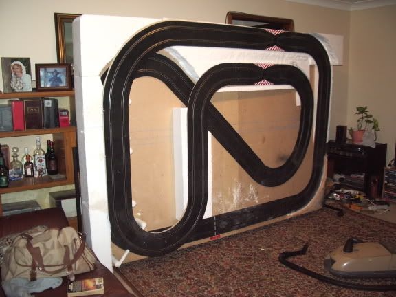

Oh yeah, forgot to mention that the stand works perfectly.The board tips from the horizontal to the vertical with one edge about 100 mm off the floor. It then locks in place with a throw bolt and wheels away into the spare room. Even the wife can do it and it takes no more than 2 minutes to get it out of the spare room and erect it ready for racing.

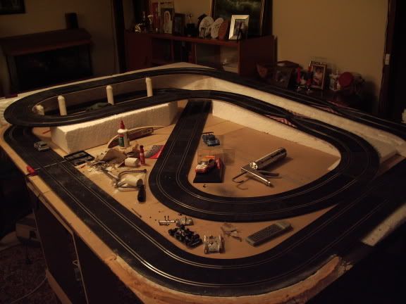

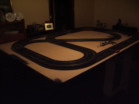

This is initial layout to make sure it all fit
Next, we have the elevations in place with most of the bridging supports in place.
The next two show how easy it is for the wife to fold it out of the way when not home.
