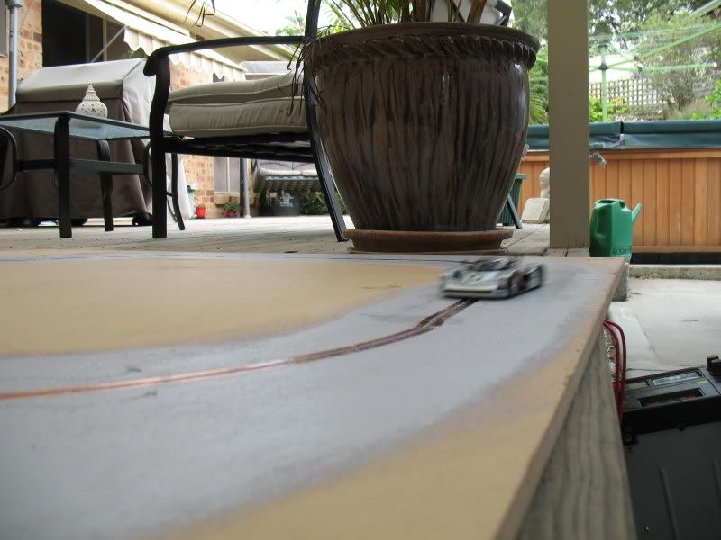

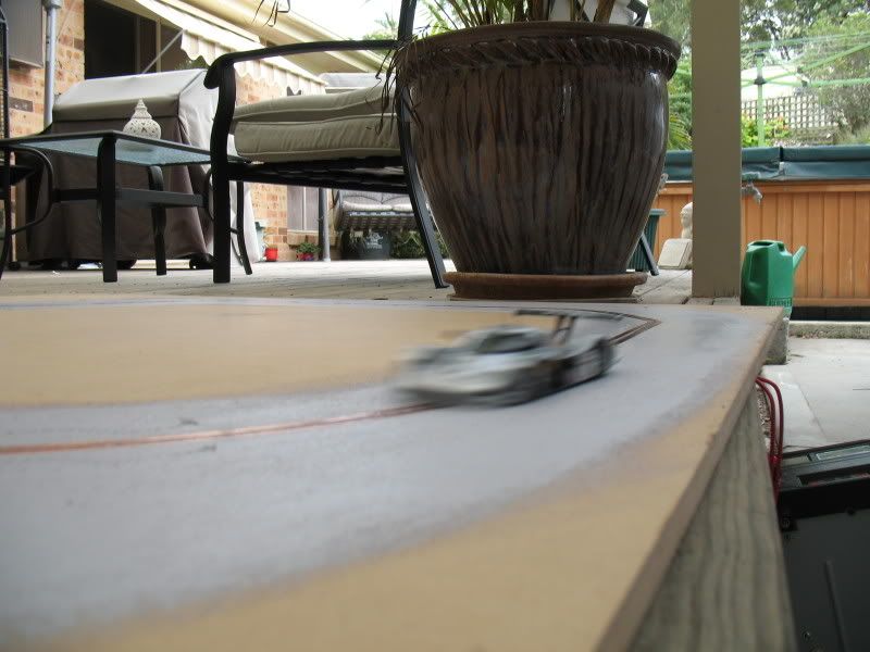

MCGREGOR168 Posted March 17, 2007 Report Share Posted March 17, 2007 Well through reading and looking at different tracks on this forum I am about to atempt a 1.5 x 4.8 rooted track. No not a spelling error probably an apt description after Iam finished with it. The old scaley track (12 months old) was my first effort in track design but it is to tight and I am forever fixing power problems The test track has been contructed out of 12mm mdf ( the final track will be out of 9mm) using a craftech carbide tipped 3mm bit . Test tape was purchased from The Glass Emporium in SA 5.56mm code xm002. Some of the routing (which is the first I have done) I used a radial arm and a template the rest was freehand. I have ordered a routing kit from Luff at oldslotracer which should smooth out alot better than freehand. The paint is cloth grey semi gloss left over from painting the kitchen. and seemed to give reasonable grip. The track design was pinched from San Phoneo then then slightly modified thank you Martin. The track was wired up direct to a variable power source for the test .The Slotit Audi which has no ballast added run lap after lap with the tail out.This car was a dog on the scaley track not the cars fault but the current scaley track had five radius 1 hairpins just to tight for the Audi. Will post more pics and info as the build takes shape. Quote WANT THAT ONE! AND THAT ONE! Link to comment Share on other sites More sharing options...
Sports Racer Posted March 19, 2007 Report Share Posted March 19, 2007 Is it really worthwhile building a test track? Quote May the downforce be with you. Link to comment Share on other sites More sharing options...
MCGREGOR168 Posted March 19, 2007 Author Report Share Posted March 19, 2007 Is it really worthwhile building a test track? Well I think it is As I have never seen a routed track,Driven a Router or laid tape . As you can see from the picys practice cuts all over the board. As I Am employed by a very large hardware group starting with B the mdf was a packer total cost of the test track (not including router or bit) was aprox $4.00 mostly tape cost. Regards John Quote WANT THAT ONE! AND THAT ONE! Link to comment Share on other sites More sharing options...

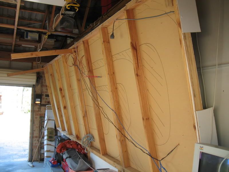

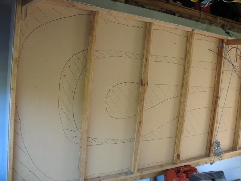

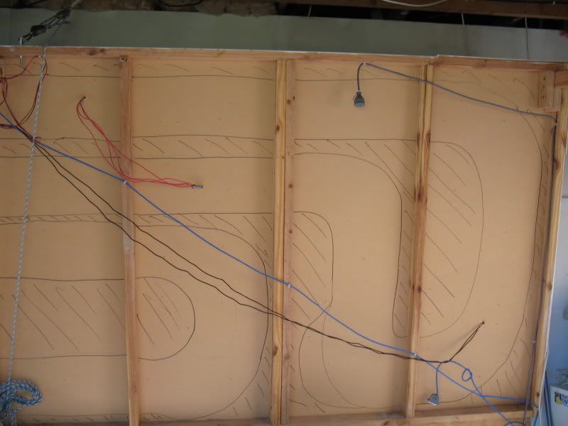

MCGREGOR168 Posted March 22, 2007 Author Report Share Posted March 22, 2007 Well Ive been drawing track plans on A4 plain paper then was going to graduate to graph paper then I had a very rare event A BRAIN WAVE. When the existing track is folded against the wall the underside is bare save for computer cables and such. So I drew the track on 1-1 scale viola! or any other stringed instument you care for. There will still be a little bit of fidling when it is drawn onto actual boards I might even use a ruler for the straights. Start finish will be approx where the blue and yellow hoisting rope is on the bottom Track will be bi directional althouth will be raced clockwise. regards John Quote WANT THAT ONE! AND THAT ONE! Link to comment Share on other sites More sharing options...
